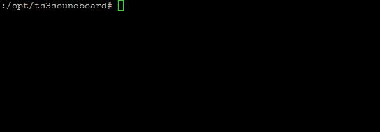

Hello, the bot crashed, and since then it will not start at all.
This is what happens. Even if i run as a user account.
The server is Ubuntu 14.04 up to date.
It was running normally before this. I put this in another folder and re downloaded it, but it does not work.
The bot is the current version. Thank you.
Edit by Mod:
SOLUTION: REDOWNLOAD THE LATEST VERSION AND UNPACK IT.

I just got Sinusbot Yesterday and it worked for like 10 hours then it stopped working and I have tried everything here and it still does not work im getting the same thing as the Gif at the top does and i need help!
bresam
Hey Guys :)
I have a problem like @iamhigher , and had it some weeks ago too.
Some weeks ago i reinstalled completly with the new version and it worked fine again after that.
Now today, after well running about some weeks, the bot crashed again and dont wanne come up.
I also tried to resetup with newest version, but nothing...
I Have exactly the same behavior like the gif of @nayne shows.
Would be greate if a fix is available
