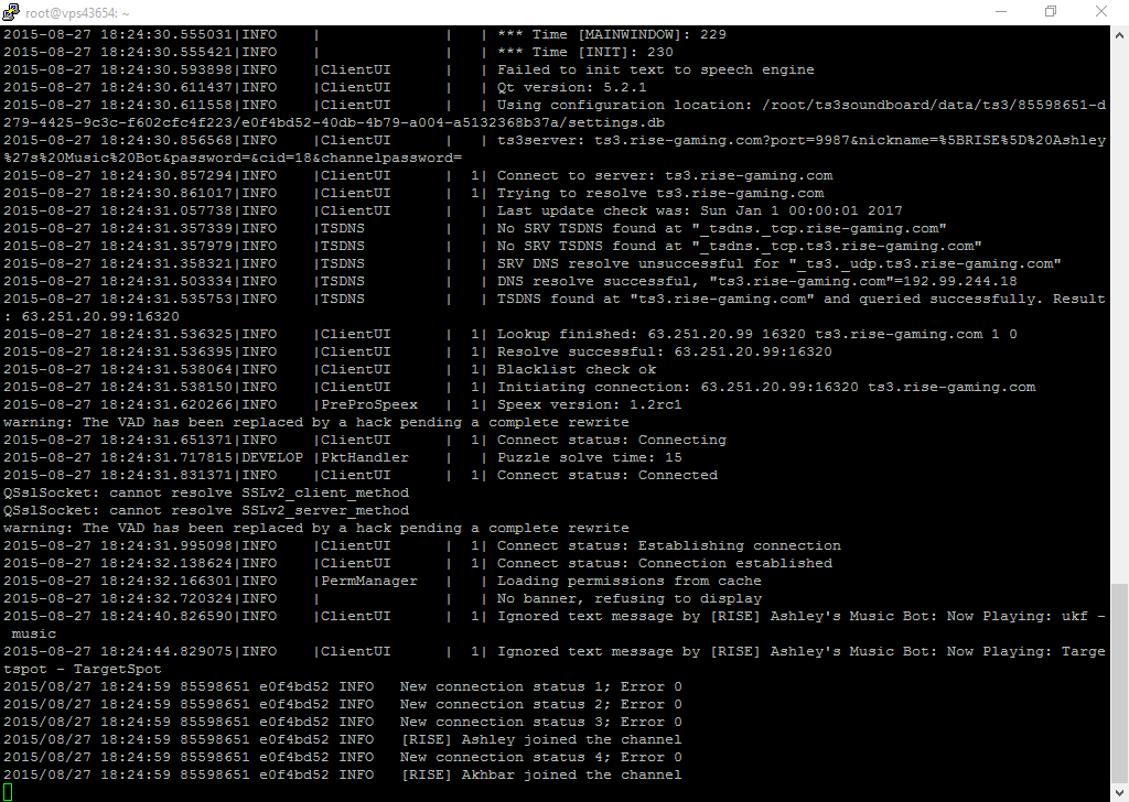

Ashley
Some output on Commandline? Can you take a screenshot, or have you TeamViewer?
Thats what i get in the terminal. It plays music etc, does not update the config file.
