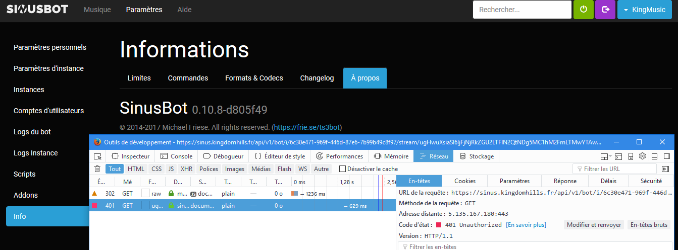

Since the update to this version a few days ago I have not been able to get the http webstream using the API. Using the Sinusbot-API-PHP class, I'm able to get the webstream token as well as the webstream, however, the page shows blank and has status code 401 unauthorized.
I have also had similar results using purely curl:
1. Login, success returns token
2. POST to https://server:8080/api/v1/bot/i/x-x-x-x-x/streamToken with the above token in header a
3. GET to https://server::8080/api/v1/bot/i/x-x-x-x-/stream/(stream token from above)
The token is returned successfully from step 2, but the GET request in #3 returns 401 unauthorized. If I include the header with the token from step 1, then it returns 403 forbidden.
