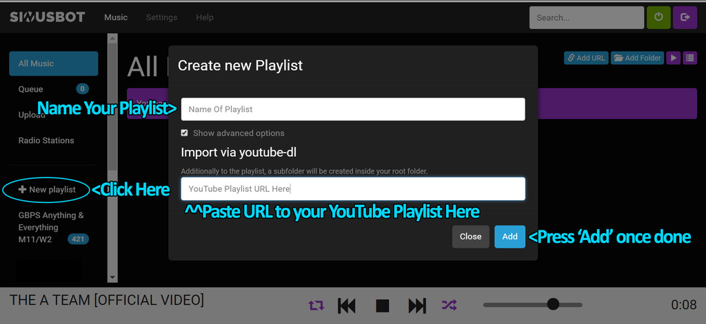

How do you play youtube playlists?
*Make sure Show advanced options is CHECKED
