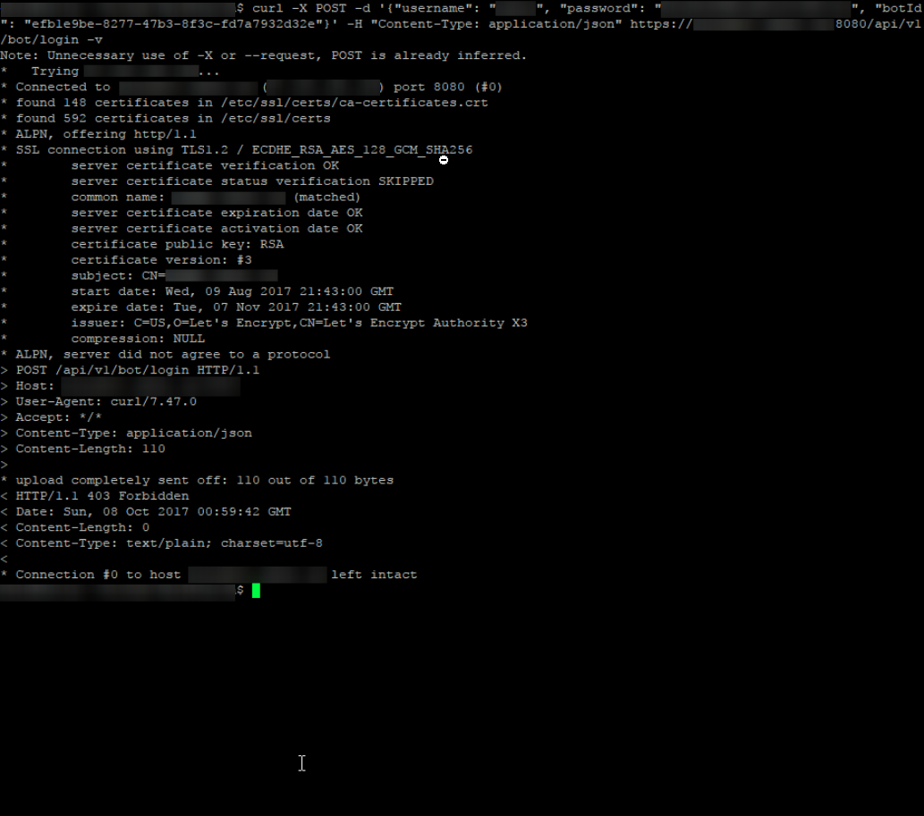

I'm not getting any response from the server using this.
I have tried on a fresh install using the install script on Ubuntu 16. I am also getting no response from /api/v1/bot/login. The page is blank in browser as CURL doesn't return any response.
I get no response from the server using this. I have tried on a fresh install using the install script on Ubuntu 16. I am also getting no response from /api/v1/bot/login. The page is blank in browser as well as no response from CURL.
Check the response status code, there must be a response or error status code.
Zahzi
Running curl with verbose mode shows 401 Unauthorized for info.
Login shows forbidden.
