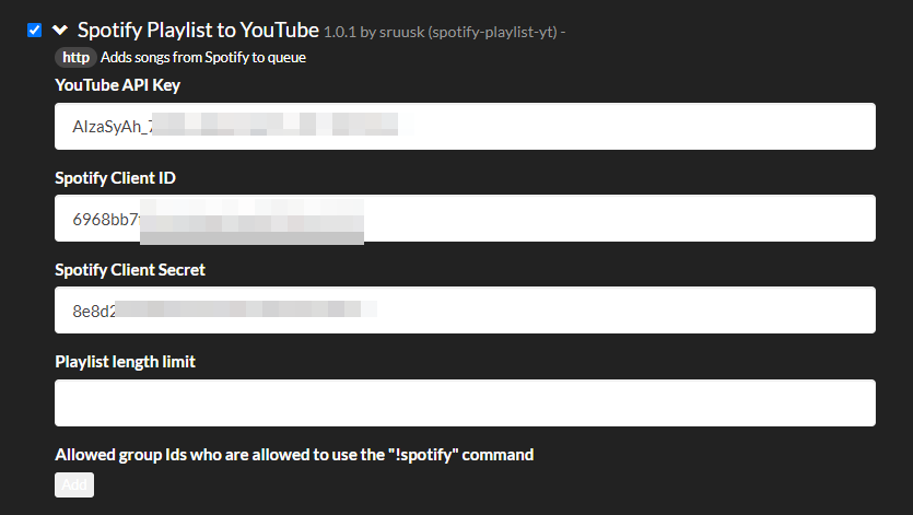

ofc i did:Have you set the spotify client id and secret in the settings?
![PKIwf5n.png](/proxy.php?image=https%3A%2F%2Fupload.cr1ms0n.xyz%2FPKIwf5n.png&hash=e02e0a8ebb98f3800ba8776199efed5a)
The error you're receiving indicates that it's failing to call the Spotify API. All I can think of is either your Client ID or Secret is wrong. Do other songs work? Do you get any errors in the sinusbot logs on the admin page?ofc i did:

ofc i did. again, checked everythin twice - cant find the problem..I assume you updated the script?
That's a 403 forbidden error, meaning that if everything else works, your client id or secret is invalid. I just tested the script again and it still works for me.
any update? also tried with a fresh new developer app in the spotify developer dashboard, same errorI assume you updated the script?
Honestly no idea. Did you select the Web API when creating the developer app? Have you checked that you don't have any spaces in front of or after the client id/secret?any update? also tried with a fresh new developer app in the spotify developer dashboard, same error

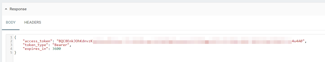

Yeahh.... I kind of suspected that might be the issue. I guess you could try changing to a different IP. Or you could try to use a proxy server to forward the requests.I have now tried it manually via a POST request but still receive the same 403 Forbidden error. Unfortunately, I'm not very familiar with the Spotify API. Could it be because I'm not using HTTPS for the Redirect URL?
I've also checked the box for Web API.
Edit I've now tried it locally from my PC and can easily request a token via a POST request without any issues. It seems like the IP of my VPS is blocked for these requests..
