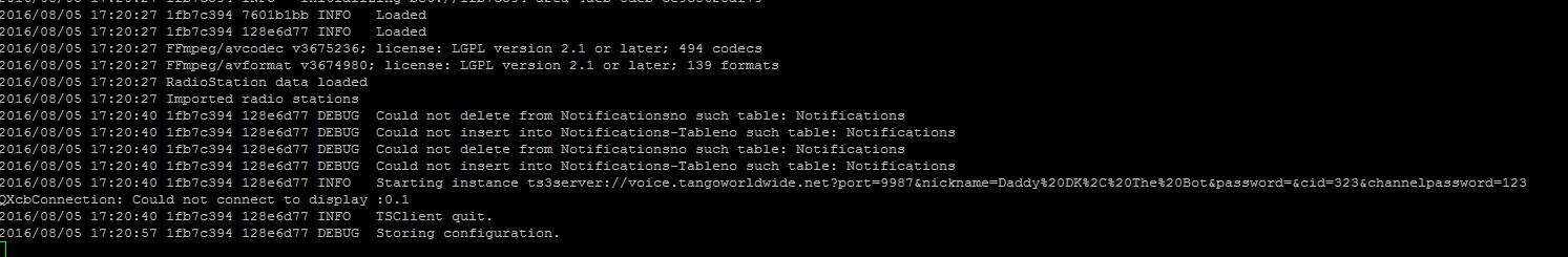

So, while the bot(s) start up perfectly fine, when they try and connect to a TS3 Instance, they don't, and just quit. Sometimes it says that it quit per the API's request, and I have no idea what's wrong.
OS IS Debian 8
Running off of a basic DigitalOcean Box, with 512mb of Ram, and 10Gb HDD
