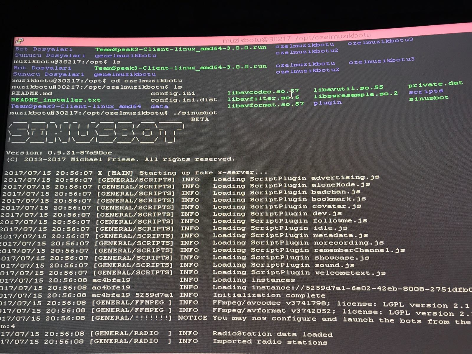

Hi everyone. Since the creator made us run the bot without root user, I couldn't and can't use sinusbot. I am not advanced in linux and found a way to open a non-root user with permissions. But still got an issue. When I type ./sinusbot it runs but I can't connect to the panel also bot doesn't come up. And I can type ./sinusbot many times before killing the process and I see the same output everytime I try. Here is the output:
Please help me I couldn't run it for a long time.
Cedt
ListenPort = 4
ListenHost = "t-speak.com"
TS3Path = "/opt/ozelmuzikbotu/TeamSpeak3-Client-linux_amd64/ts3client_linux_amd64"
This is my config.
Cedt
Woww that was easy, thanks a lot man. While running the sinusbot with root, ListenPort=4 was OK it was working even Port=3 was OK. I typed 4444 and it worked. Thanks to you and flyth.
