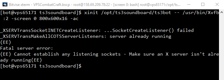

Every time I try to start my instance on the web interface it gives an error (As seen below). I am running CentOS 6 64-bit and I have followed the entire direction in this tutorial.
Error (* means blurred out):
016/07/11 18:53:39 4ff1f30a 119162a4 INFO Starting instance ts3server: //ts.*******.tk port = 9987 & nickname = TS3SB-Demobot & password = **** & channel = & channel password =?
11/07/2016 18:53:39 4ff1f30a 119162a4 INFO TSClient quit.
2016/07/15 13:33:47 7e09a4b2 a0e89a05 INFO TS>/opt/ts3soundboard/TeamSpeak3-Client-linux_amd64/ts3client_linux_amd64: /usr/lib64/libstdc++.so.6: version `GLIBCXX_3.4.15' not found (required by /opt/ts3soundboard/TeamSpeak3-Client-linux_amd64/ts3client_linux_amd64)
2016/07/15 13:33:47 7e09a4b2 a0e89a05 WARN EOF
2016/07/15 13:33:47 7e09a4b2 a0e89a05 INFO TSClient quit.
2016/07/15 13:33:47 7e09a4b2 a0e89a05 INFO Socket closed.
xinit /opt/ts3soundboard/TeamSpeak3-Client-linux_amd64/ts3client_linux_amd64 -- /usr/bin/Xvfb :2 -screen 0 800x600x16 -ac
/opt/ts3soundboard/TeamSpeak3-Client-linux_amd64/ts3client_linux_amd64: error while loading shared libraries: libquazip.so: cannot open shared object file: No such file or directory
and
help me please

Hellow,
I tried to call the BOT in my VPS centos 6, del this error:
What should I do?
2017/01/01 18:40:28 aaa822f1 1f455d4f WARN Could not request shutdown
What is this man ? How can I solve the problem?
