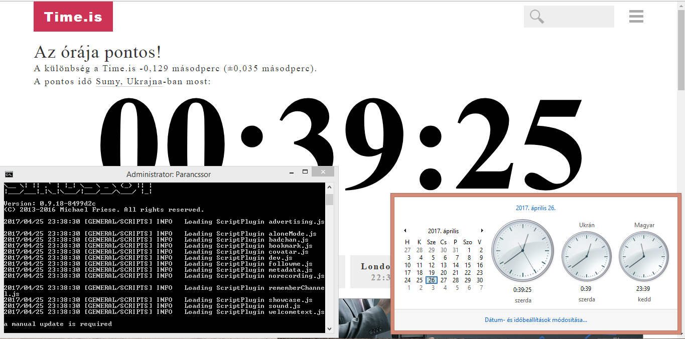

I am getting this error constantly
I've tried windows 7 (64 bit) as well as Centos 6.3(64bit)
After Updating the time, Same Error
Well.. it is saying why and what you are doing wrong. It says "WARN !!!!!!! YOU ARE RUNNING THE BOT AS UID 0 (ROOT) WITHOUT HAVING SET ANOTHER UID. THIS IS A SERIOUS SECURITY VIOLATION !!!!!!!!" So yes, don't run the bot as root or try using the parameter "-RunningAsRootIsEvilAndIKnowThat" if you can live with the possible consequences.
So you want me to change the user and try?
Well yes.. thats whats the error messages says. Its basically a LOUD SCREAM that you are trying to run a open (public) Beta service with root rights. So if the sinusbot has any vulnerability (which is likely in a beta) the attacker would have FULL control of your server.
Take it as the same warning windows gives you when you are trying to install a program and need to say yes as admin.
Nothing happened

well dunno then, normally it was the time error. But when that isn't the case and you checked it I can help any further. Maybe @flyth knows something. Wait for him or another staff member to reply
And you really don't need to bump your thread after 11minutes without a reply. This place here isn't reddit.

2017/04/30 18:18:09 X [MAIN] Starting up fake x-server...
a manual update is required

2017/05/16 19:10:23 X [MAIN] Starting up fake x-server...
i check the date and time of vps and check the firewall
and reinstall the bot , and reinstall for my vps , but the problem dosen't sloved i need help please
