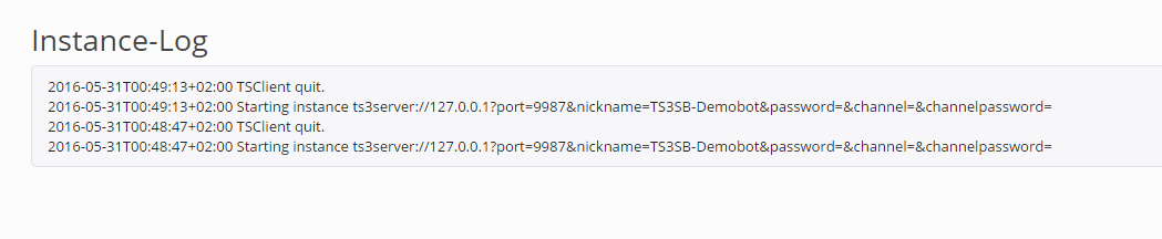

Impossible to join teamspeak with the sinus bot ;
OS : Debian 7 64
No error script all succes
error log :
OS : Debian 7 64
error log :
Sure your TS³ Server running on Localhost?
